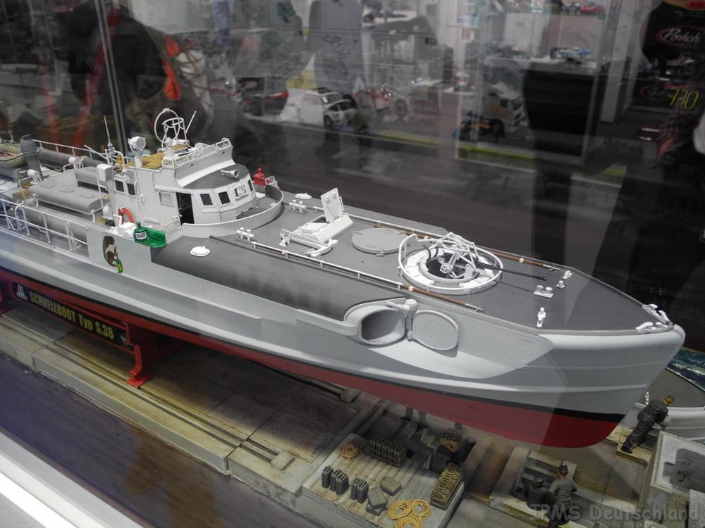

Good start, look forward to seeing more. I saw photos of this boat built up and displayed by Italeri, taken at the Nuremburg show. Looks like the error made in the diameter of the forward gun tub in the S-100 kit was not corrected. It is still too small.
Gunner would not fit behind the gun. Al

Just curious, what is that circular disc behind the 2cm gun position as
seen in the posted photo of the finished model?
Joe
TAFFY3
Joined: January 21, 2008
KitMaker: 2,517 posts
Model Shipwrights: 1,244 posts
Posted: Friday, February 09, 2018 - 03:41 AM UTC
Excellent work....those extra details will really pay off in the end!
Joe
That's the foul-weather cover for the gun tub. Al
