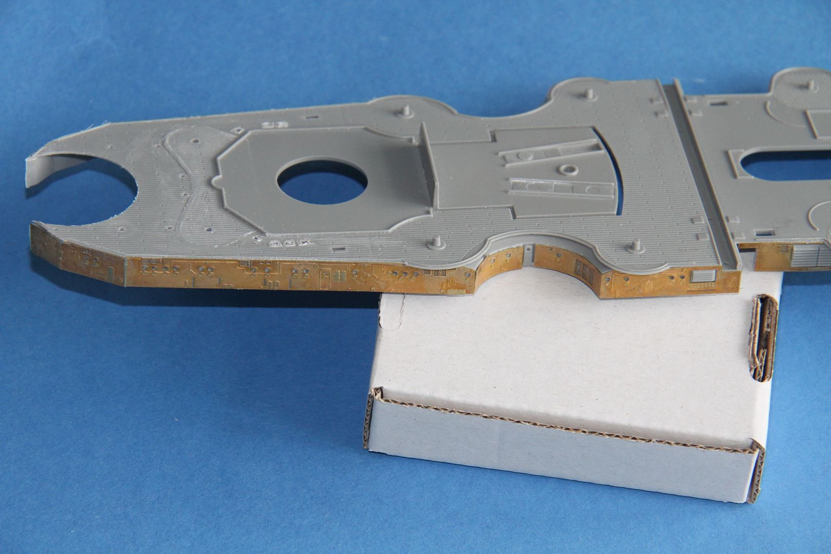

Today's update.
The shelterdeck removed from the sprue and test fitted. a lttle fight but good.
Removing the detail to allow fitting the wood decks. The forward 37mm splinte shielding.
The after ones come off too, this time along with the stowage boxes.
and cleaned up.
The shelterdeck built up and test fitted.
so far so good.
The interior hanger deck fitted.
Brass cladding for the exterior bulkheads.
Part one.
in place.
As far as got today.
The inset for stbd No.1 15cm mount goes up another dek, so that will wait until the lower bridge structure is fitted.
KitMaker: 1,458 posts
Model Shipwrights: 1,455 posts
Posted: Sunday, June 12, 2016 - 07:13 AM UTC
Very nice work, Si!!
No I am getting the idea why you think this Bismarck would take you a while to finish...but still you are making good and fast progress!! Looks fantastic!
KitMaker: 5,099 posts
Model Shipwrights: 4,684 posts
Posted: Sunday, June 12, 2016 - 08:00 AM UTC
Told you this was going to be a long build mate. These are just the cladding, there is loads of details for the vents and stuff to go on these before I can put pain on.
Thanks for the kind comment.
KitMaker: 879 posts
Model Shipwrights: 673 posts
Posted: Sunday, June 12, 2016 - 10:16 PM UTC
Si, that brass cladding looks great. certainly easier than adding doors, vents, portholes etc individually.
On your your covering for the air recognition strips are you going to try and further wash the covering away to bring through the insignia a bit more? I think it would look better with a bit of thinning.

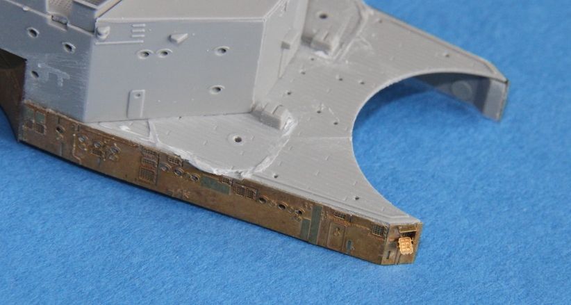

A small progress today.
The skins all on the starboard side.
Started on the port side.
Lumps and bumps removed from the after port side.
Good thing about posting, just noticed the door just aft of the catapult that needs sanding off before I go any further.
Posted: Tuesday, June 14, 2016 - 04:26 PM UTC
The 'skin' is looking good, Si - at some areas it looks as if there is more stuff needed to be added on top, or ist that a wrong impression? But even as it it seems quite an improvement over the original parts...
Off topic - Now, YOUR Hood IS big...and I thought mine would be a fairly sized model...
Posted: Wednesday, June 15, 2016 - 06:42 AM UTC
Hi Jan,
Yes there is, lots of lovely little bits to go on, gatches, lockers, mounts for booms, paravanes etc.
Yup the 200th is big, but at first blush it looks like they gave corrected at least some of the errors of the 1/350th kit. (Don't think Mrs Duster is impressed)

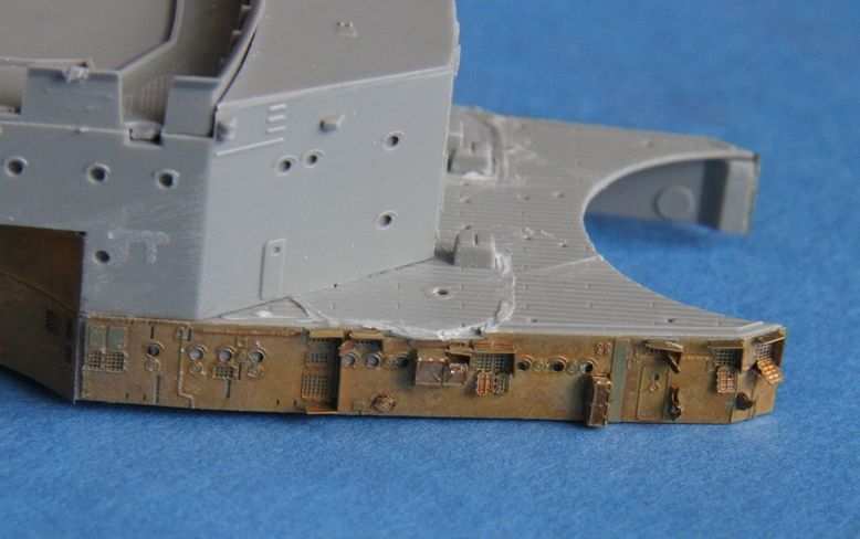

Posted: Sunday, June 19, 2016 - 05:48 AM UTC
The long slog,
The detail going on the shelter deck bulkheads.
First bits on.
The first session, in need of a break.
As far as I got today.
I haven't counted, but about 40 pieces to just that section,
Loads to go yet.
Posted: Sunday, June 19, 2016 - 05:47 PM UTC
Wow Si, those first additions on the bulkhead skin - that's amazing!! Now that REALLY makes a difference!! Fantastic work!
Posted: Monday, June 20, 2016 - 08:11 AM UTC
I am impressed the depth all these details add. It will take some very careful washing after airbrushing to bring it out.
It is some upgade set, this bit is going to be a labour of love, and I shall enjoy every minute
