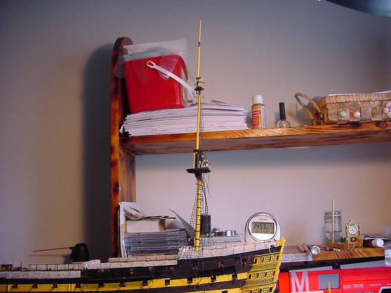

Still finishing those upper (or middle) shrouds & ratlines...seems that here and there, the nail polish didn't hold the ratline in place, so I'm re-doing selected lines again, one at a time. I think I did the last one last night, so it should be time, soon, to start putting some more elements of the mizzen mast together.
I was also reading Longridge's book, trying to get insight into how the the shrouds loop around the top deadeye (Roth's book indicates the port shrouds loop around the deadeye from the aft side to the forward side, with the starboard shrouds looping around from forward side to aft side. Or vice versa). He also mentioned that he left the attachment of the shrouds to the deadeyes as an event after placing the running rigging, as it would be easier to belay lines without having to go around the shrouds. Same idea with the stays. Seems to make sense, but knowing my luck, I'd manage to mess up the shrouds, and would have to spend twice as much time to fix things. Maybe I'll put the deadeyes in place, and loop the shrouds around them, but not finish them with glue, so I'll be able to move things around as/when required.
I've also come to the conclusion that I could use about 5 or 6 different workstations...one to store the model, a second to do painting, a third to cut & trim parts, a fourth to hold things that are glued & clamped, a fifth to hold the instructions (and re-write them!), and maybe the sixth to use as a general purpose desk! In the meantime, it's one desk, and one operation at a time...

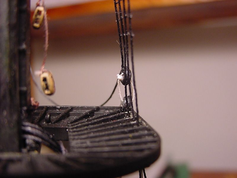

Yeah, I can probably use some of those cut-offs/cast-offs for something. Here's a pic of the current pile:

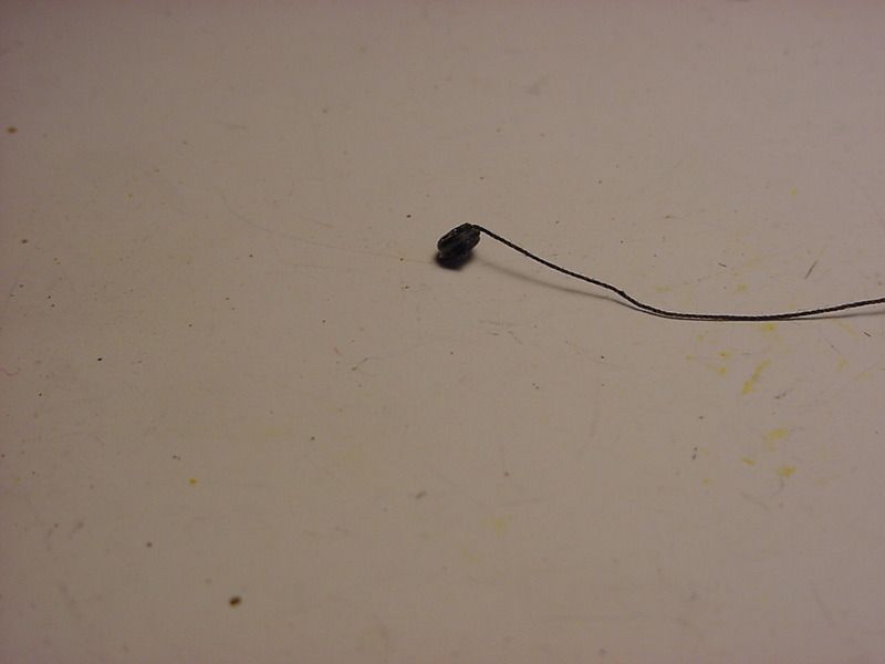

Here's my photo of what I torched:
So I've already re-strung the shrouds and one side of ratlines...waiting for the glue to dry, and to see what the glue didn't secure the first time around.

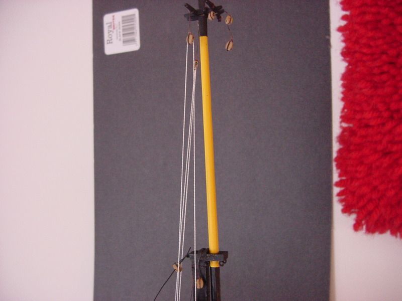

Well, I've re-strung those middle mizzen shrouds (H6, in Heller's terminology, and if my memory serves correctly!). So that puts me back to where I was about two or three weeks ago. And I can see I will have a similar problem as before: my bonding agent, for some reason, didn't adhere the ratline to the shroud, so I'll probably spending too much time fixing things there.
On a more positive note, I drilled out the holes on all the "p" blocks. I was doing that drilling with a pin vise, but after a while, my fingers would get all achey and crampy, and I said to myself, "there's got to be a faster way"...and there was! I was able to chuck the drill bit into a Dremel tool, and the drilling went faster. But I had already cut off a handful of the blocks from the sprue, so the difficulty there was keeping the drill bit perpendicular while a pair of tweezers held the block. So on about the last 60 or so blocks, I drilled out the holes while they were still on the sprue, thus eliminating my problem of perpendicularity of the drill holes.

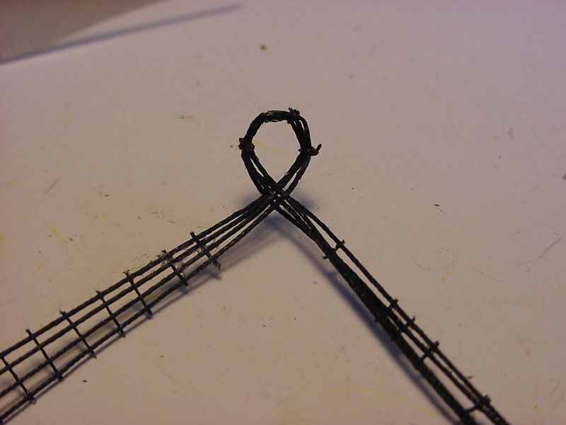

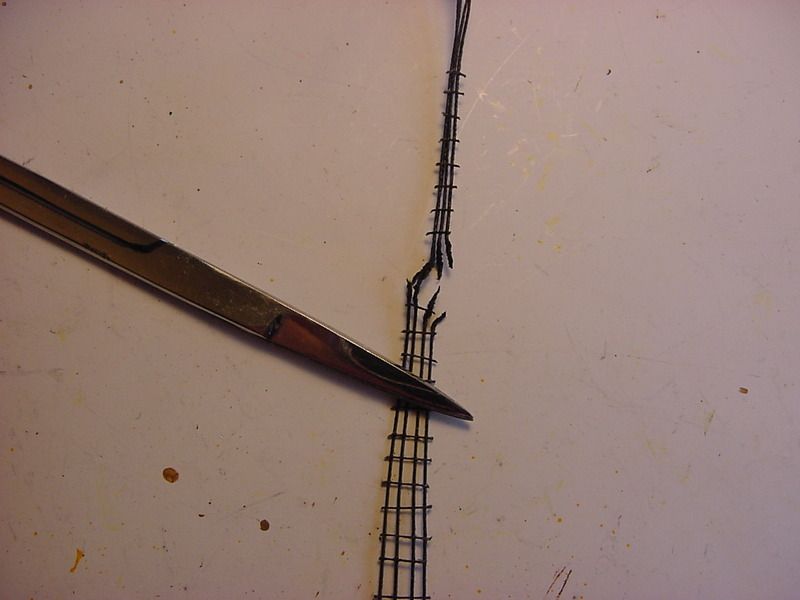

Well, I finally got the second set of shrouds for the mizzenmast completed. It seems, though, once I started to cut the excess ratlines away, a lot of them weren't sticking to the shrouds, so I had to do them over and over and over.

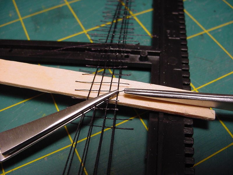

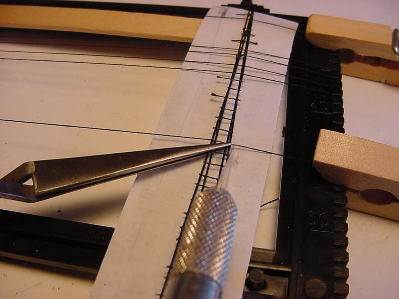

Here's a couple of pictures of how I trimmed the ratlines. My big fear/problem was, in trimming the line, the ratline would come in-done from the force of my blade, so I was using one set of tweezers to hold things in place, another tweezer to put tension on the thread, and then slice through with a knife blade. Of course, this had its own dangers, in that if I didn't put the first tweezer exactly on the joint, I ran the risk of slicing through the shroud. And of course, I kept everything away from open flames!
Here's a close-up with some of the excess thread cut away:
After I removed the shroud from the frame, the part of the shrouds that would ultimately go around the mast, was separating from each other, so I tied a couple of knots around the shrouds to keep them together.

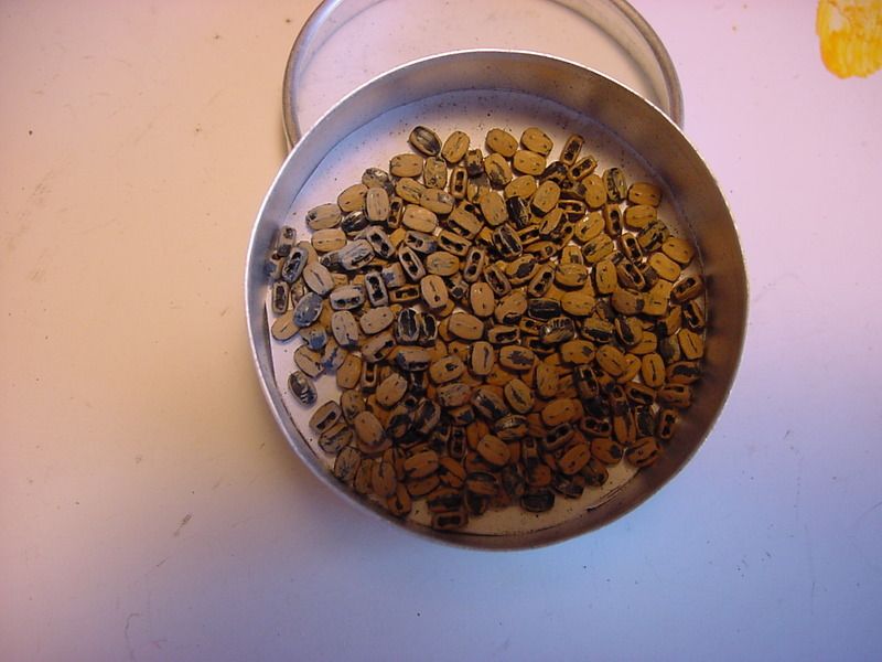

And lastly, a note about the parts count. The picture below is what 221 "p" blocks look like; that's all of the remaining "p" blocks. These blocks aren't quite ready to go, I still have to cut the groove on each side so the attachment thread has a good place to get seated.

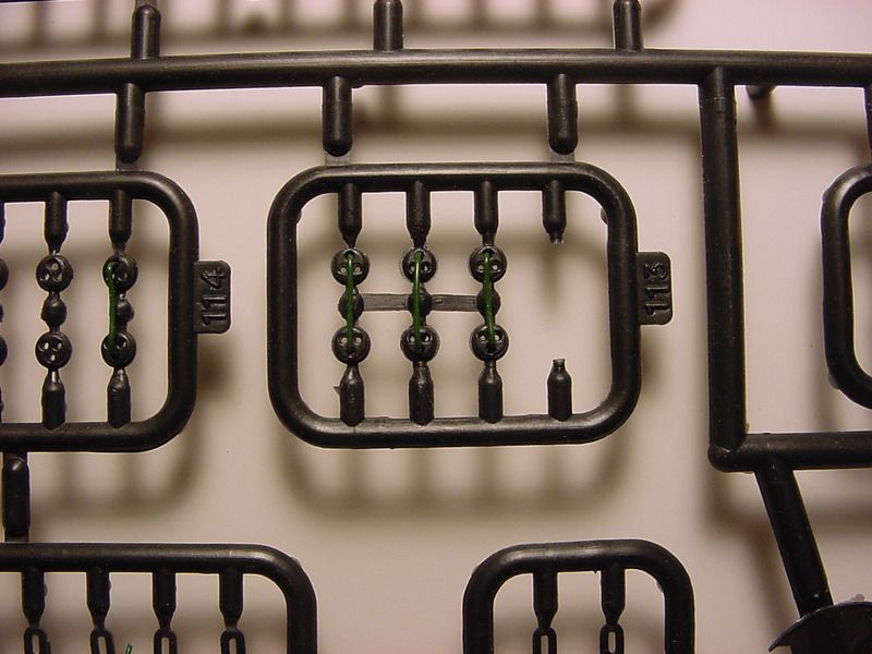

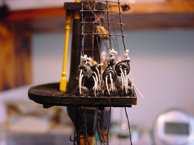

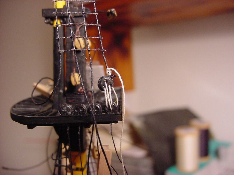

Managed to get started on making up the deadeyes for the upper shrouds on the mizzen mast. Going a bit slower than I had hoped for, but, taking my time and not rushing things, should give a better result!
So before I started cutting off the pairs of deadeyes, I ran into this little problem:
The problem being that there is the connecting pieces of plastic between the deadeyes, as well as a left-to-right connection. So instead of being able to just cut the deadeye pair from the sprue, it means taking out the small wire I was using as a spacer, cutting off the express plastic, making another (or, a second spacer) wire, cutting off the deadeyes from the sprue, cleaning up the deadeye, and getting ready to attach a thread to what will become the lower deadeye, which is what we see in this picture:
Not the best picture, but the thread is wrapped around the deadeye, with care being taken to try and get the start & stop point of the thread just underneath one of the eyes in the deadeye. There also seems to be a bit of a flange going around the deadeye, so that helps to align the thread. When wrapping the thread, I start right about underneath a single eye, then wrap the thread around about a third of the way, so I can cement the thread in place, let it dry, and then move on to the next third.

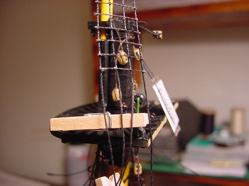

For the upper deadeye, here's the shroud getting wrapped around the deadeye. The shroud got started on the outside edge (like, the 3 o'clock position), then followed around in a clockwise direction, with the excess of the shroud hanging down (before I trimmed it):

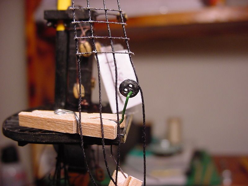

As you can see, it took some specialized clamping tools to keep the deadeyes upright - here's a pic. In this pic, I haven't wrapped shroud around the deadeye yet.
Here's a picture of the knot that holds the thread between the deadeyes in place. I tied the knot 5 times; I guess it only needs to be tied 3 time or less. Also, I've shifted to using #70 drill bit to open the holes in the deadeyes. I might, on the next set of deadeyes, use a needle to help thread the string through the deadeyes.
And here's the final product:
The light colored thread is wrapped about 3 times around the shroud before I finished it with an overhand knot, and some cement.
So here's a question for everyone: I see mentions about people using "CA" glue. I thought this was an abbreviation for cyanoacrylate(?) glue, which, I believe, is the same thing as super glue. However, people talk about keeping their CA glue wet, or solvent, when it's not capped. So, is this CA the same stuff as super glue? And does it not dry as fast as regular super glue? And if it's not the usual kind of super glue sold in stores, what brand names/other names is this glue sold as?
Look forward to your replies! And thanks for taking a look - right now, I've got the other 3 lower deadeyes on the mizzen mast installed, and just waiting a bit for the glue (Testor's ) to get good and dry, before I try putting another deadeye/shroud combo in place. Wish me luck!!

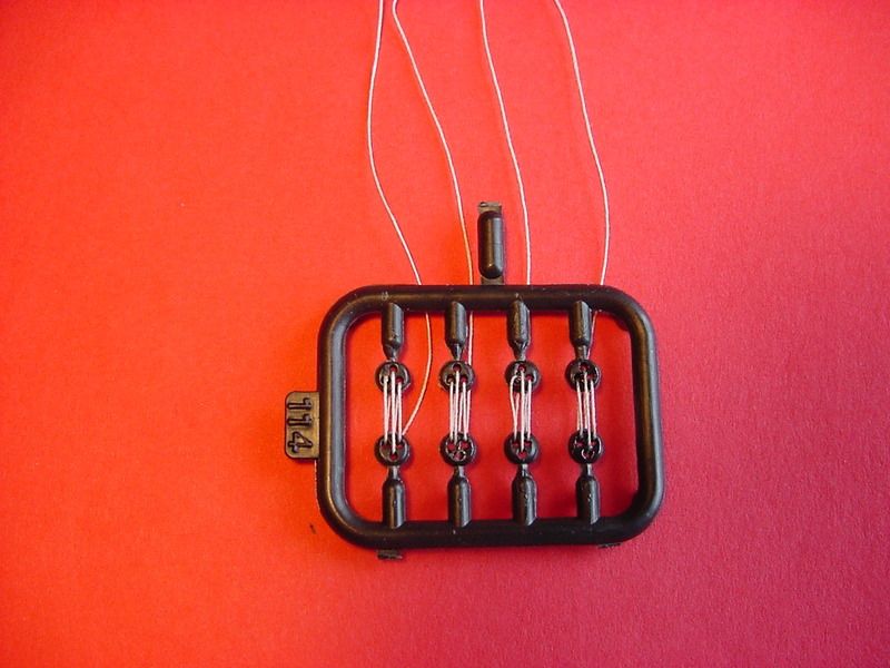

And speaking of deadeyes, my "Plan B" was to thread the deadeyes while they're still on the sprue, and then glue the bottom deadeye onto the mast top, and use the shroud to take the slack out of the deadeye. It was a semi-effective method, but probably loads easier than trying to use that floral wire to keep the distance correct. While the method is semi-effective, it doesn't look all that great once installed. Pictures will be forthcoming.

Here's a pic of the netting before:
This is how the starboard upper deadeyes turned out. A sort-of problem I encountered, was that those deadeyes fit very tightly against each other, so it wasn't easy to get the shrouds to fit around the deadeye, and still maintain some kind of evenness in all three planes:
And here's a picture of the hack job done on the port upper deadeyes:
As I mentioned previously, here is my plan B for threading-up the deadeyes: it's essentially Heller's plan, to thread things up before installing them. In this case, every time the thread went through a hole on the deadeye, I put a drop of cement on it maintain the distance between the deadeyes. However, as you can see in the above pictures, once installed, the "height"of each deadeye wasn't always even. I'll try to do better on the rest of the deadeyes!!
And finally, I did my bravery test a few days ago, and cemented the mizzen mast in place.
Now that the mizzen mast is in place, I'm looking at the decks, and doing some touch-up painting on them, before I get a bunch of rigging in the way, and it becomes nearly impossible to get a paint brush down on the deck. I'm still considering using a black wash on the main deck, just to highlight the engraving. My fears, of course, is that I won't make the wash "thin" enough, or if I do, I won't make enough to cover the whole deck, and even if I get the formulation right, when the wash dries, it'll look like crap. Oh, woe is me!!!
