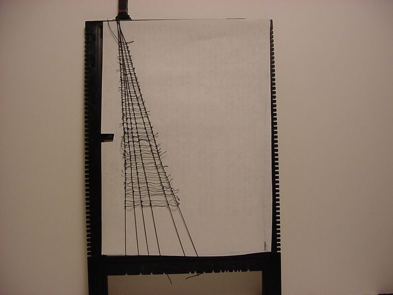

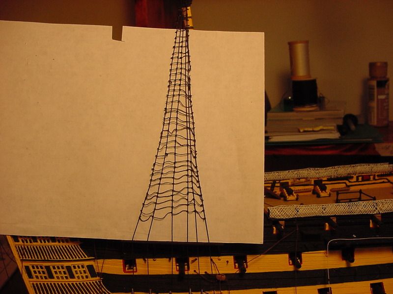

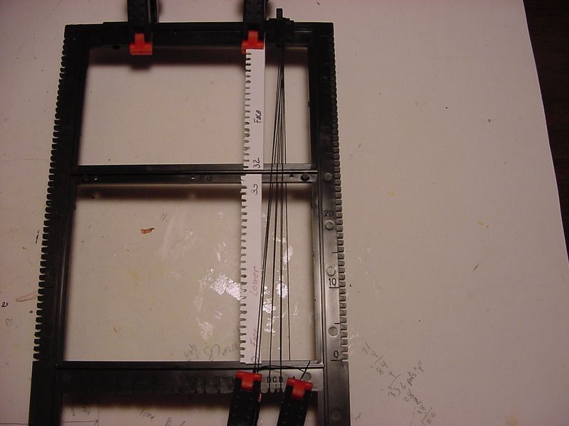

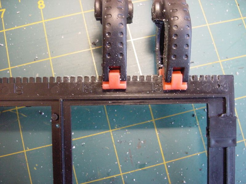

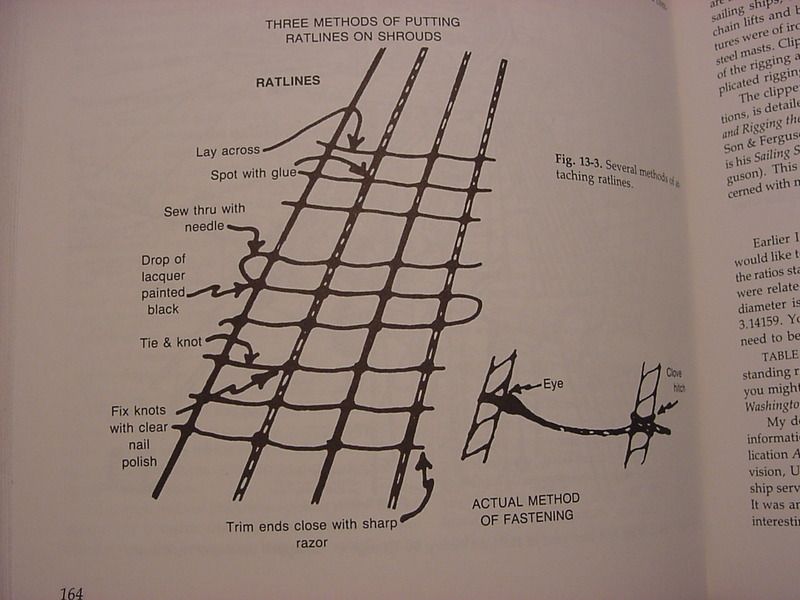

Posted: Monday, January 09, 2017 - 05:39 AM UTC
Mizzen mast lower shrouds
Well, I've been spending quite a bit of time trying to make-up the mizzen mast shrouds. So far, I've managed one side of the lower mizzen mast! I haven't timed myself, but it takes about 30 minutes or so to try and thread maybe 3 or 4 ratlines across the shrouds. And believe me, after doing 3 or so ratlines, I'm ready to call it a day.
I made mention before that I've read a few tips in Milton Roth's book, "Ship Modeling from Stem to Stern". Here's a picture of the foremast foreyard that is illustrated in his book:
And here's his take on how to attach the ratlines to the shrouds:
Here's a picture of the frame that Heller includes in the kit. I had a little trouble attaching the square piece to the frame, that holds the futtocks in place. I thought the problem was the slot on the square piece wasn't big enough for the stem; turns out, the holes that hold the piece in place weren't big enough.
And lastly, here's the finished product (this is just the port side lower mizzen shrouds, still on the frame). The ratlines are supposed to go up several more rungs (the frame is notched on each side, and the numbering starts at 50 at the top, and goes down to 0). The last bit of ratlines (from 46 to 50) are going to be very short in length, so I might just glue string straight across, rather than try and tie a bunch of knot through there. BTW, if I did knot everything, it would be a total of 468 knots, just on this set of shrouds (6 shrouds times 39 ratlines times 2 sides). I slid a piece of paper behind the shrouds, so that they wouldn't cast a shadow on the starboard side shrouds, thus making for a confusing picture (confusing - that's quite the word to apply to this effort!)
In case you're wondering, the sequence was to start on the left-most shroud, tie a double-overhand knot, take the long side under the next shroud, then up and back over the same shroud, then under and up from the ratline, and then taking the free end and pushing it through the loop that was made when taking the string up through the shroud. And that's why it takes 30 - 40 minutes to string just a couple of ratlines!!
Thanks for watching, and hopefully, the next post will have both sides of the shrouds completed.

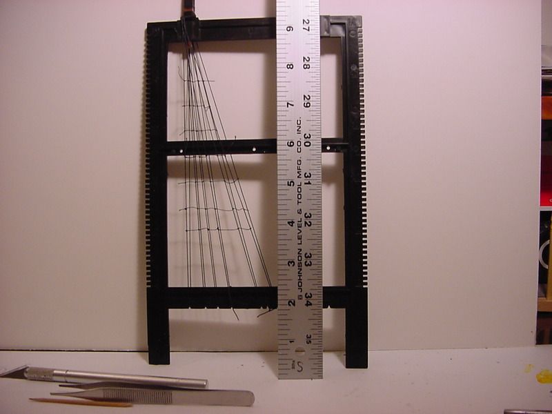

Posted: Tuesday, February 07, 2017 - 08:50 AM UTC
Hi-ho!!
Not much to say, still working on the ratlines (at least I've moved over to doing the starboard side!). Things got a bit off-schedule in early January, as I had a tooth pulled, and there was just a lot of difficulties afterward.
I think, on the remaining shrouds, instead of knotting each ratline at the intersection of each shroud, I'm just going to lay a thread straight across, glue it in place, and try to use the cut-offs on other shrouds.

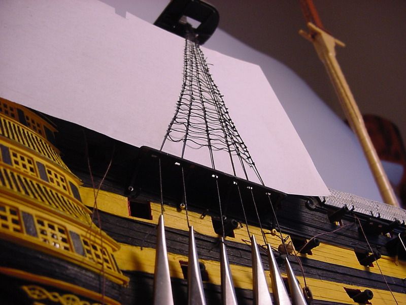

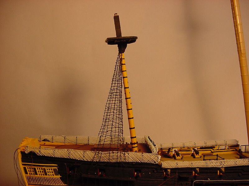

Posted: Tuesday, February 21, 2017 - 11:10 AM UTC
Woo-hoo! Finally finished the lower mizzenmast shrouds & ratlines....some pictures to follow shortly. I've also come to realize that the upper part of each lower mast assembly needs to be painted black, and not yellow! Scraping, sanding, and re-painting is in my future!

Posted: Saturday, February 25, 2017 - 08:28 AM UTC
Damn - I don't believe this. I was proofreading my post, when somehow I got flipped to one of the advertiser's websites, and now my post is gone. So here we go again:
This first pic is of how I managed to cross the shrouds as I was winding the thread around the futtock:
This next one, shows how horrible the stbd side looks:
The port side looks a little better:
Without any backing paper:
Here's the broken shroud:
And here's an interesting view:
So like I mentioned in a previous post, I feel like, once I cement the mizzenmast in place, I'll be really, really, really committing myself. Which is good, because maybe it will keep me motivated to chugging along.
I shaved down the lower part of the mainmast today, as it wouldn't fit all the way to the hull bottom. This was/is due to the mis-alignment of the lower deck halves. I tried to use a file to enlarge the hole below decks, but as usual, I was getting impatient, so I decided to shave the mast (which was easier!). However, now that I've gotten it to slide all the way down, I can't find the square hole that will accept the peg on the bottom of the mast for a good fit. So maybe I'll have to cut off the peg and just use a massive amount of glue to keep the mast in place.
As usual, thanks for checking things out!! BTW, our spring-like weather came to an end today after the rainstorm moved through...I guess I have to wait until Wednesday or so for the temps to be back up in the seventies.

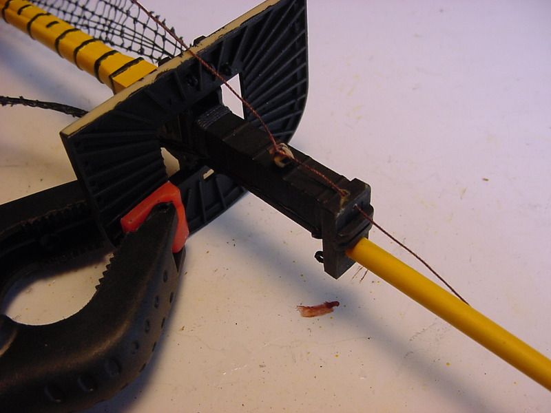

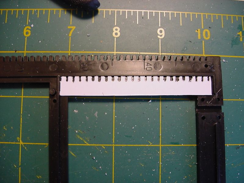

I thought I'd make a jig to match the ratline/shroud frame that Heller added to the kit. The thinking here is, instead of wasting a lot of thread stringing the ratlines across a lot of "empty space", I'd make something that would match the slots for the ratlines, but wouldn't use up so much thread. Here's cutting part of the jig:
And here's the finished part. This is the "upper" part of the jig; it's made to fit between the top and middle part of the ratline frame:
And here's how it all goes together:
So, before I got started on cutting that jig, I thought I was well on my way to finishing putting the mizzen mast together. I was all ready to put the next segment of the mizzen mast on, when I realized that I needed to make-up another set of ratlines before I could proceed. I was also ready to start adding the blocks to the mast, as per the instructions, when I noticed two things: that block P21 seemed to get attached to the mast cap, and that another set of blocks (not sure what the designations are) needed to go between the lower segment and the middle segment of the mast. So a word to the wise: before adding the mast cap, add those 2 blocks, then put the mast cap in place.
To get P21 to fit, I drilled a hole through the mast cap, and threaded P21 through the hole. I started to make the hole with my Dremel tool, but the bit "caught" and gouged a part of the mast cap - nothing too bad, just copious paint to hide the gouge. I finished the hole with my pin drill:
To try and make sense out of where all the blocks go on the mizzen mast, and which they face (fore, aft, athwart), which line goes through them, where that line starts, and where it belays, I made a rough chart for all that, so when I'm actually putting the rigging in, I don't get too flustered with having to flip through several pages of instructions. I also made a similar chart for the spanker boom & spanker gaff (not sure I have the correct names). IF anybody would like a copy, let me know, and I'll see about getting a copy to you. I'm going to make similar charts for the mizzen yards, as well as for the fore & main masts.
Would you believe it took me like almost 3 hours to cut that ratline jig? I sure hope it's worth it! And if none of the photos in this post are present, it's because Photobucket was a little more recalcitrant than normal tonight. At least, I was able to do a load of laundry while trying to make this post!!
