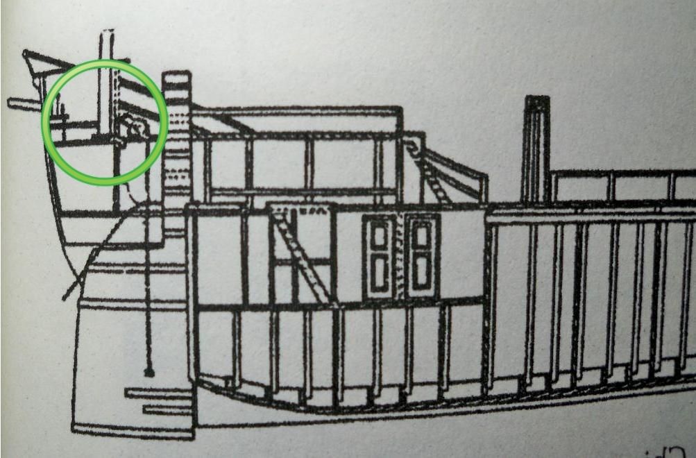

Nice work with the tiller Tim,
Just a thought, but would the tiller not be up on the poop deck, or at least somewhere where the helmsman could see where he was going and the set of the sails.

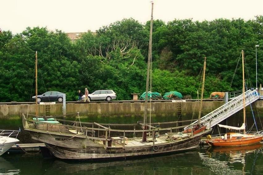

Ok, I will be the second spoil sport..... Looking at the image you posted with the sails, wouldn't the mizzen mast go through that compartment? It is starting to get pretty crowded in there, but I doubt that would stop the fun...
However, I have faith that you will make it work.

I think you’re right! I had followed the pattern of rudder control from inside the cabin based on European ships of the 15th Century (as with my previous Nińa and Pinta builds), but I forgot that Chinese ships were very different! As in the photo below, I’ll probably go with your suggestion and reposition the tiller to the upper deck aft:
Bob,
I too had thought the mizzen would extend through the cabin to be anchored deep within the vessel as with European ships, but again, Chinese design was VERY different! According to Hans Van Tilburg’s Chinese Junks on the Pacific - Views from a Different Deck, junk masts were not set deeply into the hull but were rather sandwiched between fixed mast partners; “...the weight of the mast was carried to the two mast partners, supported by the deck beams, bulkhead partner brackets, and carried only indirectly to the thwart ship mast step, obviating the need for a single massive keelson.” So the light mizzen mast didn’t anchor much further down than the poop deck itself. You can see this in a drawing from G.R.G. Worchester’s Junks and Sampans of the Yangtze:
I must admit, Chinese design remains mostly a mystery to me – the masts were not only shallowly anchored, but they apparently had no standing rigging to support them, either – but at least it frees up the cabin space below for other activities!
