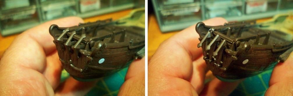

Thanks guys. I’ve been thinking about how to fit the anchors. The instructions show them mounted like in this picture from the boxtop of the Lindberg re-release:
This seems wrong to me. The anchors are awkwardly perched way out front without any support – they would have been immediately swept away in any kind of sea. Worse, there is a hawser leading into a “hawse hole” which Pyro had mistakenly placed in the hull. Actually, junks didn’t use hawse holes; the windlass for raising the anchors was located on the deck above, and what Pyro had depicted as a hole was actually a painted “dragon eye”, a feature once common on Chinese (and, as I recall, ancient Mediterranean) ships.
I patched the holes with .120 inch discs of .010 plastic. As for the positioning of the anchors, here are a couple of options which might make sense:
Which looks more likely?

I'm thinking the anchor layout in your left photo is more plausible. It would require less man-handling for storing/releasing the anchors and the anchors could be secured to the rail above in high seas.
Just my $0.02.

Agree with John regarding the Anchors, the right hand picture doesn't look as seaman like, the kit method positively odd, the damage that would be caused if the fluke end of the anchors broke loose.

John and Si, thanks, I think you guys are right about the anchor stowage – I’ll probably secure them as you recommend.

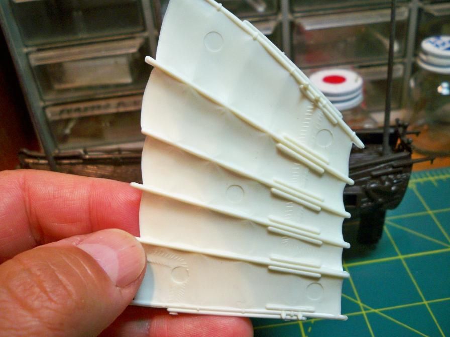

Moving on to the sails, they are attractively depicted in three molded plastic parts. In typical Pyro fashion, they are handily represented as single billowing units with the battens (spars) already in place. Although simplified, this approach to sails almost always looks better than those vacuform things so often found in sailing ship kits. I find these more robust molded styrene sails much easier to work with too.
The one big disadvantage of molded sails is the circular knock out pin marks often found on them. Knock out (or ejector) pins are used in the injection molding process to apply a force to eject finished plastic parts from molds, and they often leave circular marks. This is especially true of older kits such as this one.
The three sails had a total of 18 of these knock out pin marks on them, but fortunately they were all located on the less visible concave sides.
I scraped them away one by one with a curved X-acto. It wasn’t the most engaging part of the build, but it was a pleasantly mindless exercise I could accomplish while sitting with my son watching the 300 Spartans take on the Persian Empire on DVD – so time well spent!

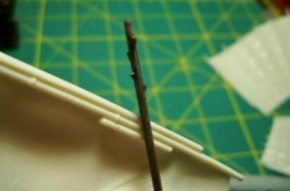

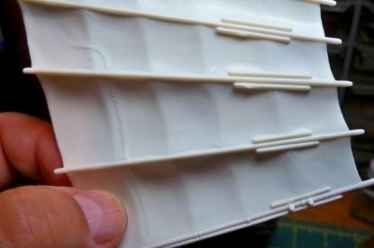

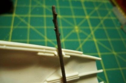

Another small task with the sails was to remove the little pins for aligning the masts from the battens.
It isn’t a highly visible change, but those pins really shouldn’t be there. I always regretted leaving them on my Niña and Pinta builds.

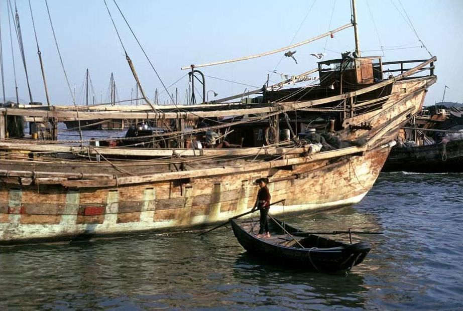

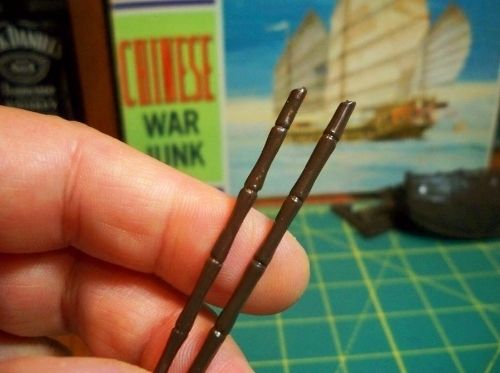

This is a fun little kit, but the scale problems have sometimes been hilarious. My favorite is the bamboo poles. You can see them mounted to the junk’s sides on the boxtop of the Lindberg re-release :
They do look like bamboo... but the kit parts are MASSIVELY oversized for the ship at something like 1/35th scale!
Interestingly, real junks did carry what look to be spare battens or beams lashed to their hull sides – possibly these were sometimes wood, sometimes bamboo? Here’s a picture of one in Macao in 1977:
The bamboo pole parts in the kit are clearly oversized, but I wonder – should I go ahead and use them anyway, replace them, or maybe just leave them off altogether?

Replacing them with wood would look ok.. but looking at the box art they do mess up the lines of the ship, id leave them off, the hulls too cool to hang them off the side. Also you can then hang other things over the side like sacks, drying fishing net, tire? did they have tires back then? probably not

They look way thicker than even the masts so unless they have a particular function like cushioning between ship and pier I would either replace them with poles the size of the battens or go with Bob's recommendation of leaving them off and hanging other stuff over the rails. I like the idea of fishing or cargo netting. I believe the bumpers would probably be made of woven rope bundles kind of like those I've seen on some DUKW trucks in the water.

As for the bamboo, honestly no idea what they are for... I would definitely not use those kit's parts, they are too oversized... some good ideas here already!
