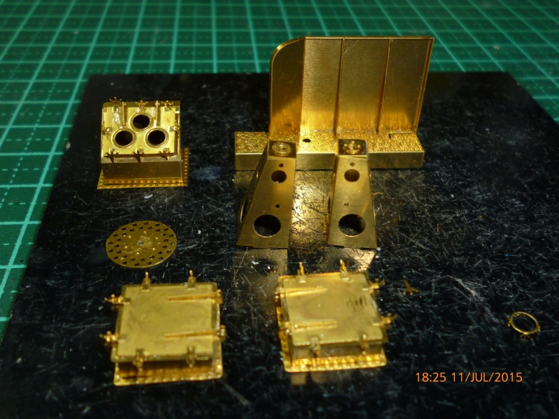

Now it is back to the anchor windlass winch.
I have to apply some filler to that handle on the back of the winch and attach the two steam pipes and valves that go into the deck..
Then we have some more pieces I have been folding.
And finally making sure the foredeck is glued down properly
